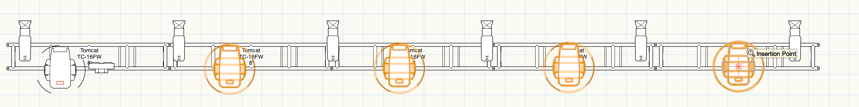

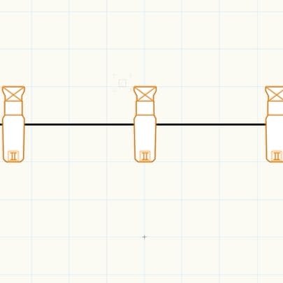

Duplicate Along Path
The Duplicate Along Path command creates and places several copies of your lighting objects along an existing path. If your 2D object and 3D paths are selected, the 2D object is projected onto the path.
To duplicate lighting objects along your path, select the object or objects to duplicate, and select the path object, which you can draw with the Line tool. Once the Duplicate Along Path dialog box opens, you’ll be able to choose from the following options:

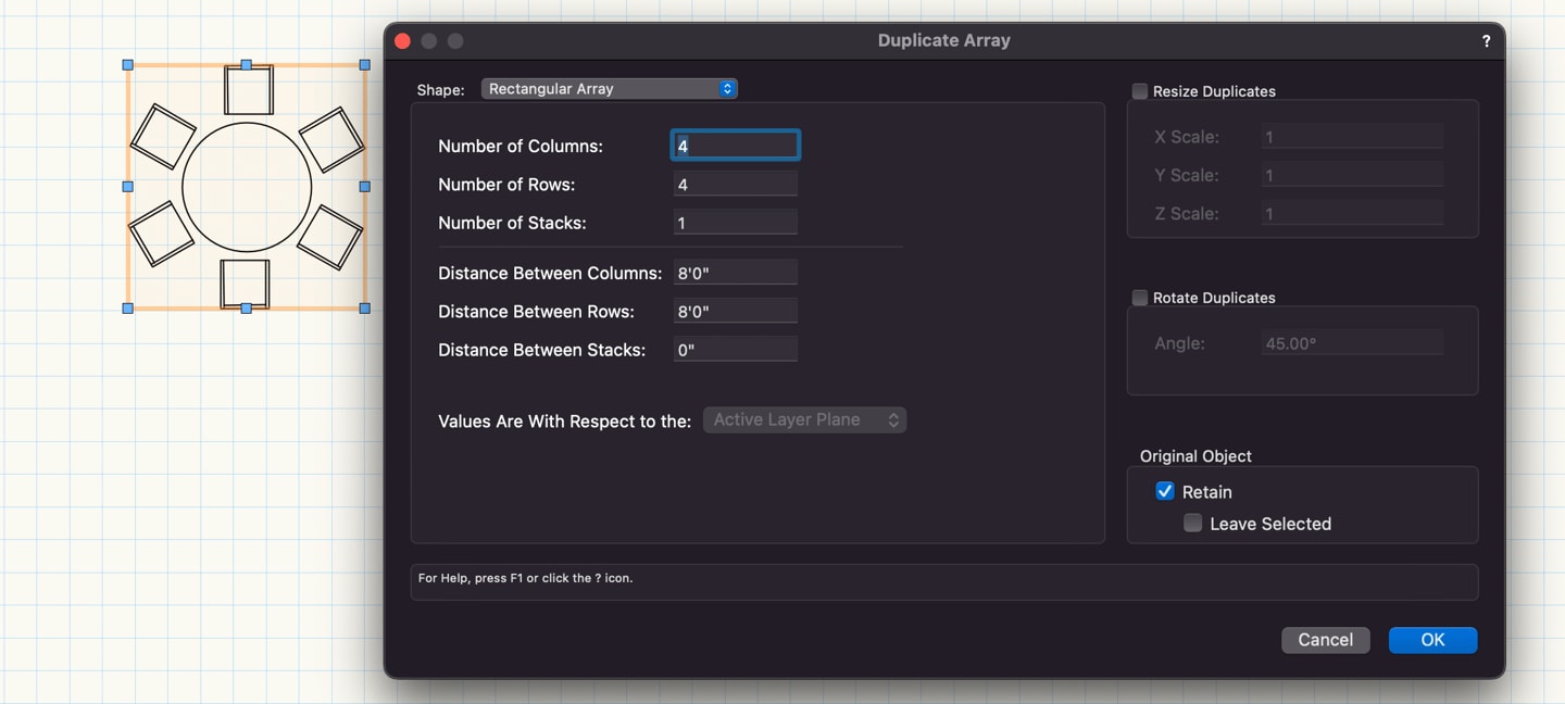

Duplicate Array
The Duplicate Array command controls how many copies of selected objects are made and how these copies are arrayed — or placed — in the drawing.
To create a duplicate array, select the lighting object that you want to copy, and select the command. Then, once the Duplicate Array dialog box opens, select your desired duplication array shape.
You can create linear, rectangular, and circular arrays of your lighting objects.

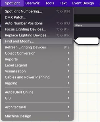

You can quickly and easily search lighting devices and accessories with custom search criteria by using the Find and Modify command.
Once you find your device or accessory, you can also use this command to perform actions upon them. This will save you time and let you move on to your next design task.

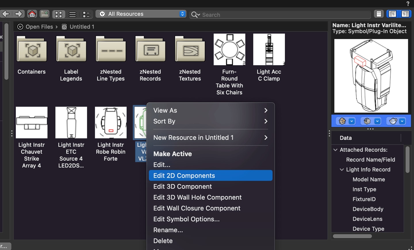

If you’re creating 3D models of your lighting designs, you can reduce your 2D workload by using 2D components for symbols. With the feature, you’re in complete control of the detail level your symbols and plug-in objects display. Your 3D light objects, for example, also come with a 2D representation that makes generating plots and other paperwork painless.
Simply right-click to edit the detail and display of any 2D/3D hybrid object so it draws exactly as you want in plan, elevation, and section views.

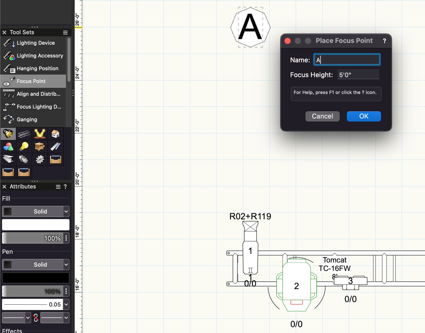

The Focus Point tool in Vectorworks Spotlight determines where your lights are pointing, so it’s a necessary step in creating light beam representations. The focus point tool also lets you create practical and artistic looks that are familiar to programmers.
You can efficiently create focus points that you can assign to multiple lighting devices, saving you from the time-consuming burden of assigning focus points to each individual fixture.
Lastly, it’s important to remember that — in 3D views — lighting devices rotate automatically to aim at the focus point. For the same behavior in 2D views, select “Automatically rotate 2D to focus point” within your Spotlight preferences.
